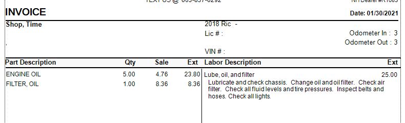

I would like to know how to have the invoice for LOF to be a single line item, combining parts and labor - "Oil Change, 5Q - $55.50" or the like. I want to be able to enter the specific information on the Order and to run accurate reports showing costs, actual filter part numbers and oil type. I have tried utilizing "kits" and "packages" but neither will allow me to combine all of the amounts to one line item on the invoice.
Has anyone else successfully managed this?

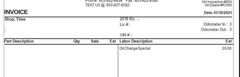

Packages will do this for you. You can put any number of labor and parts lines within one and the invoice will display only one line.
Below is an example of an oil change billed normally with parts and labor itemized.
And here is the exact same oil change placed within a Package.
