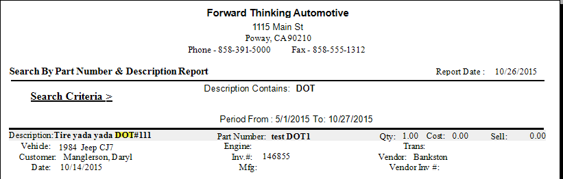

- Posts: 4537
Re: Tire DOT Registration
Better yet, the Management - Part Number Search report is even easier:

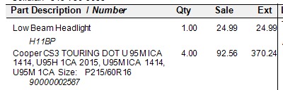

- Posts: 755
- Location: Iowa
Is this how you are saying we should do our DOT numbers so we can search for them?
- TIRE.jpg (22.32 KiB) Viewed 7718 times
- Posts: 4537
Yes, I'd say so. %DOT would find the invoices with DOT within the description for History Search function. Part Number Search - use the Description "contains" option for returning results with DOT text.
If you want to locate specific DOT numbers, care must be taken to get the input done properly (spaces or no spaces) or use something like %DOT U95% to insure results.
