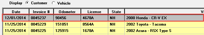

Re: Crediting Tech With Hours After Invoice Is Paid
You will have to unpost the Invoice. Go to the History tab and highlight the Invoice.

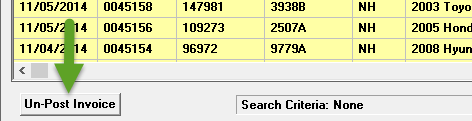

Then click the unpost button on the bottom left.

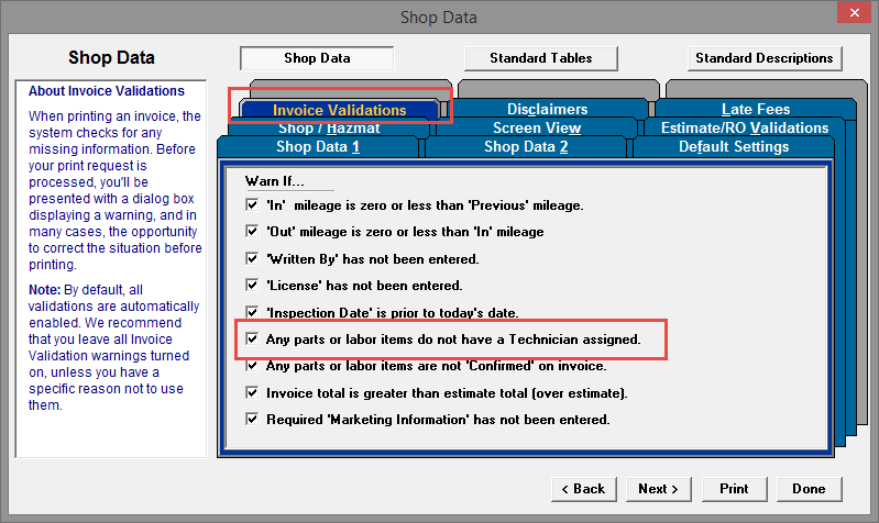

If you want to prevent this from happening, go to setup>shop data>invoice validations and check this box....
You will get a warning if you don't have a tech on a labor item.
