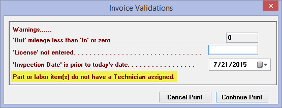

I am running 6.6.10. I am generally very good at not letting a RO get very far with out a Tech being assigned. But today I slipped up. Customer at counter, I am clicking the mouse, and get this error... Hey Idiot you forgot to assign a Tech to the RO....Cancel print - continue print.
Of course i wanna assign a tech so I hit CANCEL. The only thing this does is not physically print on paper, everything else happens. Am I missing a setting? I would love it that once I am told I screwed up, and hit cancel, that I got thrown back to the RO/Invoice so i was allowed to assign the Tech. Or even have a box pop and give me the chance to assign. Does the system have this and I am missing it??

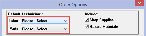

That dialog cannot support assignment right there because you have what, 2, 5, 20 items that could conceivably have differing assignments. OTOH, if you simply want to make the same assignment for the entire order, go to Options and use the Tech Assign drop-down lists there to make a global assignment:

I think I follow what you're saying Rich. If your first print of the Invoice is during the pay/post process, your choice of Cancel or Continue only affects the actual act of printing. The invoice will post regardless, because printing it first isn't a requirement.
Re: Items Missing Tech Warning
Tim, yes i have the warning set, and generally use that box to assign the tech to RO. But you get the warning after it is to late to simply turn around and assign. You are to a point that the system has just about done everything except physically print the paper.
Silky, yes. From beginning to end. We MAY print an estimate, but no tech is assigned at that point. I do my best to print a tech worksheet. But this time it was a simple LOF and no tech worksheet was needed. I didn't catch that I had not assigned a Tech. I had to go back into history and do it. We do NOT print a invoice before the vehicle is picked up, only when the vehicle is being picked up.

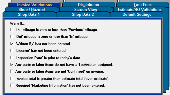

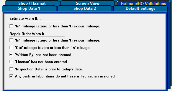

how i have my stuff set up
- how my RO warnings are set up
- Capture.PNG (9.44 KiB) Viewed 5023 times
- How my Invoice warnings are set up
- Capture1.PNG (12.13 KiB) Viewed 5023 times
