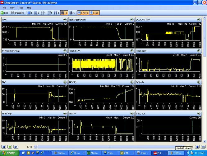

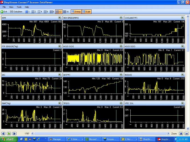

Customer comes in with a 2000 Honda 2000, sporty little two seat go kart on steroids.
60,000 miles, CEL, random misfire codes but ran smoothly and the customer said he had not noticed any misfires. Cleared codes, scheduled him for a tune up. Back in three days, same codes. Replaced plugs and test drove. Noticed after test drive that you could hear a noticeable blubber out the tail pipe. Captured this movie …..
Scanner help said possible exhaust valves. Didn’t want any part of that. Checked compression and leakdown, nominal and consistent. Never been a big fan of induction cleaning but something said give it a try. Afterwards, drove the same test route and came back, no misfires. Captured this movie.
Differences were kind of subtle. Oxygen sensor maybe a little more active, hard to tell. Pulse width dropped by 0.1. Significant but not very noticeable. The most noticeable change is at the DOWNSTREAM oxygen sensor. From full rich to lean. And the misfires were gone. Maybe induction cleaning aint a waste of time after all.

Let’s see if I can put this in a little better perspective. The first two images I posted were before and after ‘movies’ of test drives of the same vehicle taken with a Solus Pro scanner. Both show that the vehicle was driven at highway speeds and then allowed to idle for a period of time, as shown by the VSS and RPM graphs. If we compare the other graphs with each other, we see very little difference with one exception, the downstream oxygen sensor (second row, third column). The output of the downstream oxygen sensor is not used in computing fuel mixture or timing. It is used to indicate catalytic converter efficiency, an EPA function. But what we see here is that before we cleaned the upper intake, our output was well above .5 volt but was well below .5 volt after we cleaned the intake. What this shows is that before we cleaned the intake there was sufficient unburned fuel in the exhaust that when it was burned in the converter, there was very little oxygen left, giving us a rich indication at the downstream sensor. After cleaning, we now have more oxygen left in the exhaust, giving us a lean indication. This means that we are burning the fuel more efficiently in the engine and not wasting as much fuel that is being burned in the catalytic converter. This is also indicated by the difference in injector pulse width, but the difference there is so slight it is almost imperceptible.
