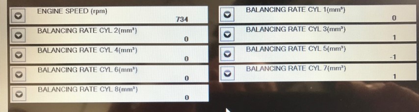

I do not have any screenshots of before. I use low sulfur usually from Murphy's. It's all low sulfur around here. I did not use an additive before but I'm using Stanadyne now and will continue doing so.
Here is the after balance rates. I stand corrected 3 of them are at + or - 1. When I got done they were all at 0 but I didn't monitor them very long. I just wanted to see what they read.
- injector.jpeg (58.58 KiB) Viewed 15201 times
Re: What Brand Injectors for Duramax?
OK, that make sense. Is that Snap-on? It looks like they round up, or down, the balance rates. Anything below .5mm3 is 0 and above is 1mm3. 2.5mm3 would show 3 I'm assuming.

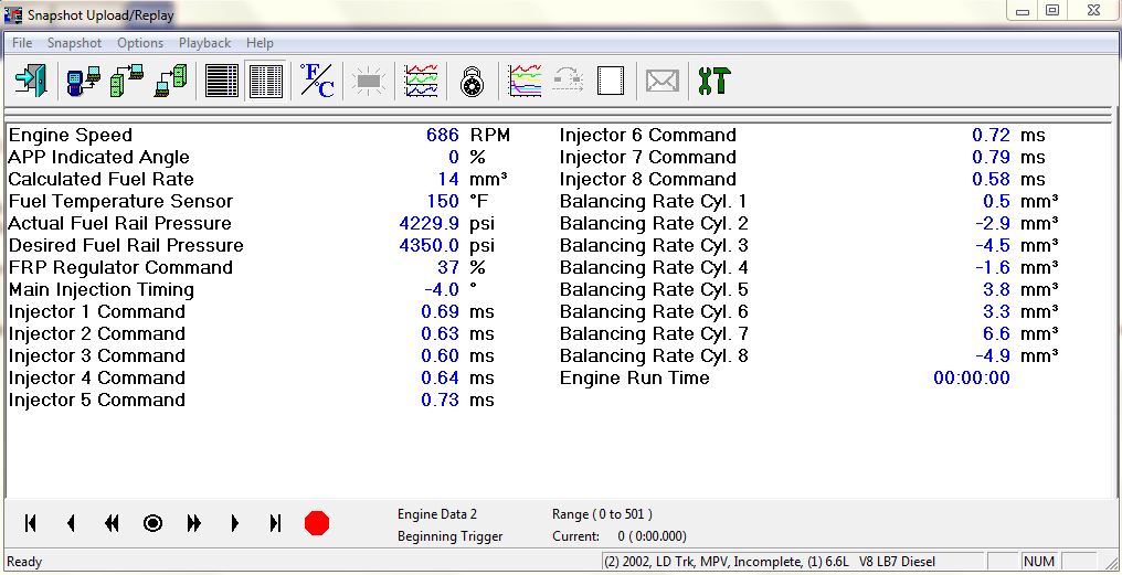

Here's what GM's software looks like from a typical LB7 with injector problems... And then after replacing the injectors...It's good, but none are reading 0. None of yours would be reading 0 either, but that's some anomaly with the way your tool processes the Balancing Rate PID's.
