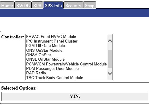

Re: 2005 Chev Trailblazer - Radio Troubles
I should have also mentioned once your in TIS2Web, you're selecting SPS, and select Radio from the drop down box. You would program it the way you would a PCM/ECM/TCM, or any other replacement module.
- Radio.JPG (36.67 KiB) Viewed 14902 times
