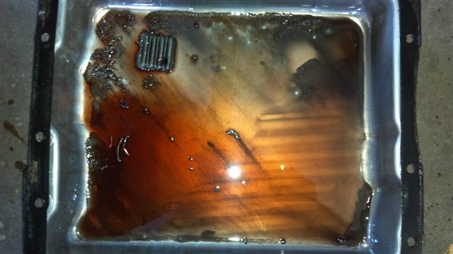

Re: GMC K1500 - Transmission Noise
Got a better look at it. The noise seemed more up front than it really was. Pulled the pan and it had metal laying in it. Ordered a remanufactured transmission.
lots of debris
brianp87 wrote:lots of debris
Yes and amazingly it worked perfect other than the noise in 1st and reverse
