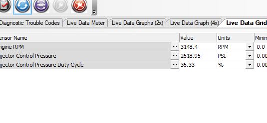

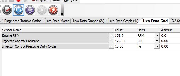

liljoe
Posts: 1638
Re: 2000 Ford E350 - 7.3L Int Running Problem
Post by liljoe »
7.3 wot uphill.JPG (27.26 KiB) Viewed 7796 times
7.3 at idle.JPG (31.34 KiB) Viewed 7796 times
Those codes were retrieved with cylinder cont test on scanner, as soon as test finished the truck smoothed out and shut key off did KOEO and injector buzz test, both passed, started back up and did cont test and it passed. Left that spot and went a couple miles up hill and at the top it did again. Coasted to bottom and found a place to pull over. All I did was cycle the key off and right back to start, truck started and ran fine. Did a couple screen shots of idle and wot pressures/%. The sensor is reading correctly ( I test the sensor with a manual gauge set up ) The IPC sensor is on driver side, so I know its reading is gonna be accurate for that bank. If I unhook an injector and run cont test, all I get are cont codes for which ever cylinder I unhook. If I run buzz test or KOEO, I get electrical codes for affected cylinder. My thinking after running with different combonations of unhooked injectors and power supply wire is that the cont test does not look at anything except for the engines smooth running ability, and KOEO and buzz tests will check electrically.
