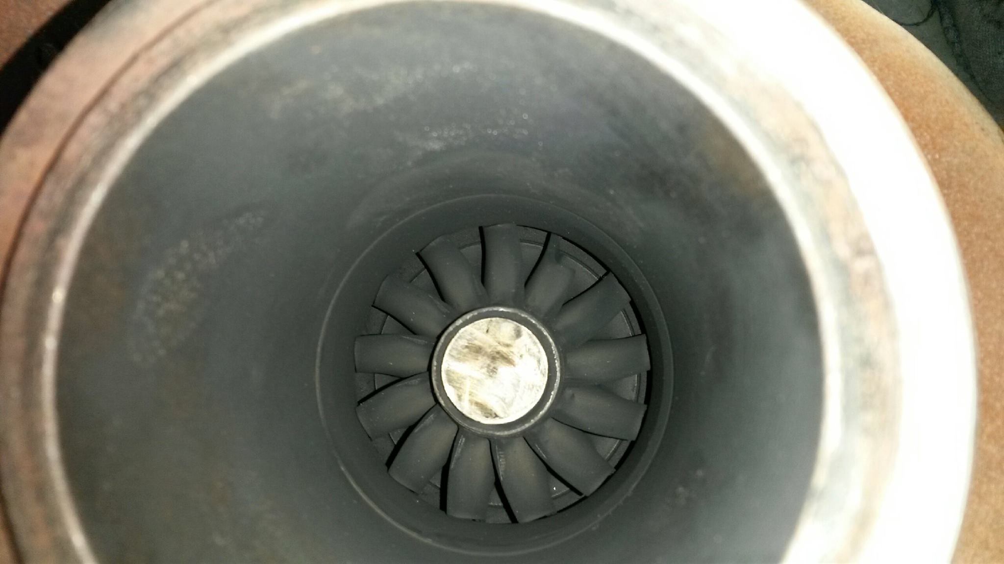

We fixed the vehicle it was time consuming to find the issue. The turbo we did a while back had a broken blade. Since I haven't gotten a lot of hits ill let you all know what it was so hopefully if you run into it it will save you some time. The oil cooler coolant passages were plugged. The engine oil temp was getting hotter then the coolant temp not a lot but enough to shut the turbo down under heavy load and not enough for a fault code. I think when the vehicle overheated in the past it burnt the silicant in the coolant causing the restriction.
Amb turbo 3.jpg (151.64 KiB) Viewed 7351 times
