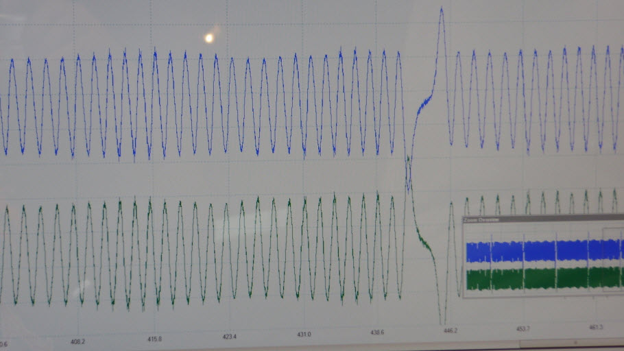

I have seen failures with out codes on these, look for a nice even pattern on the crank sensor with one double wide place on it. I happen to have a pic I took of a screen running the pico scope (on a friends computer)with the crank sensor hooked up on two traces, ( you could do one trace and it will be OK too) the scope was hooked up with the lead from each of two channels hooked up to the sensor and the ground lead from the scope hooked to ground. The way I like to hook to them is just one channel and hook both leads to the scope like normal, but this will give you a good idea of what the crank sig should look like.

I would have thought that it would be a square wave.
Thanks alot for the picture. It sure is nice to be able to use technology like this to aid in our work. I have the truck here so I will scope them. By the way, is both sensor signals the same?

Yes, they are both magnetic signal generators. Hope some of this helps you out, I have several pics of different things on those, and would be glad to share if needed.

Hey ok. This info helps me out greatly. I was thinking that perhaps somewhere on this forum there could be a section of known good wave signals that could be viewed. But yes, your input is greatly appreciated.
