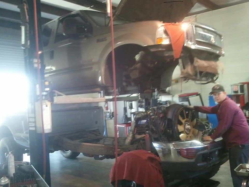

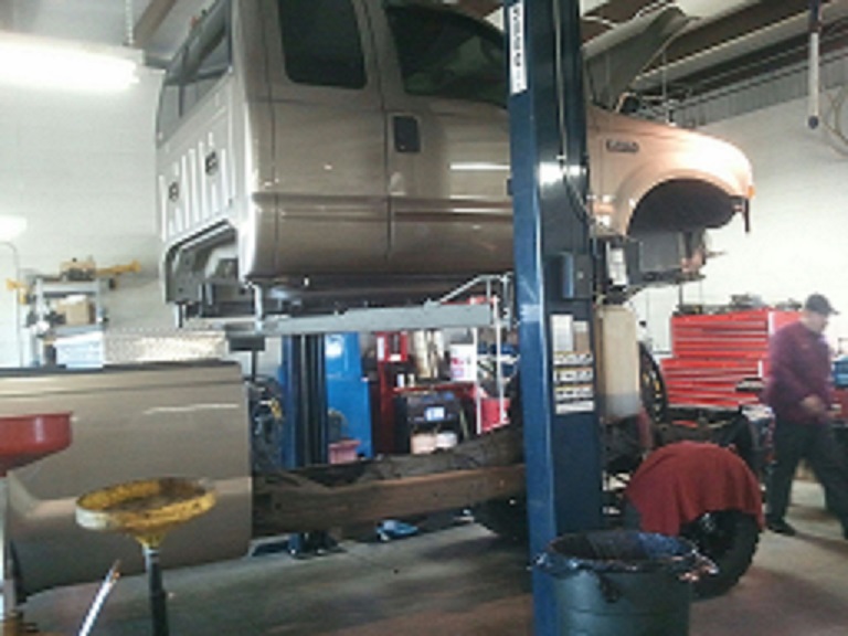

Interesting. Glad you got it figured out. Got the cab off one now.

Re: 2004 Ford F350 - 6.0L Fuel Injectors
Were doing egr delete, head studs etc on this one. I ordered the new style feed pipes to find out this one is an early design which we haven't seen before and they are different.
Yay
