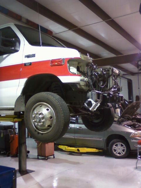

On some of the ambulances the cabs cannot come off and we take the front end apart for removal.
- amb1.jpg (71.29 KiB) Viewed 10841 times

Yea, the E vans present a different type of challenge, especially with the diesel engines in. But I agree with others comments, these Ford vehicles give us alot of work due to the sheer numbers of them out there and the issues they have as well as the fact that many shops prefer not to work on them. But we enjoy this type of jobs and do many of them, not limited to Fords though.

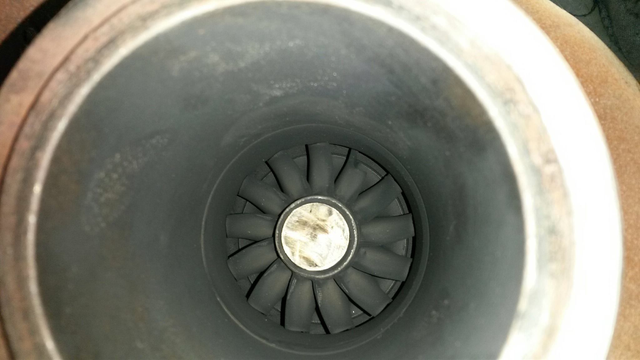

Its true. I think the ford diesels after the 7.3L are all problematic. Personally id be upset if I owned any of them.
- Amb turbo 3.jpg (151.64 KiB) Viewed 10832 times
