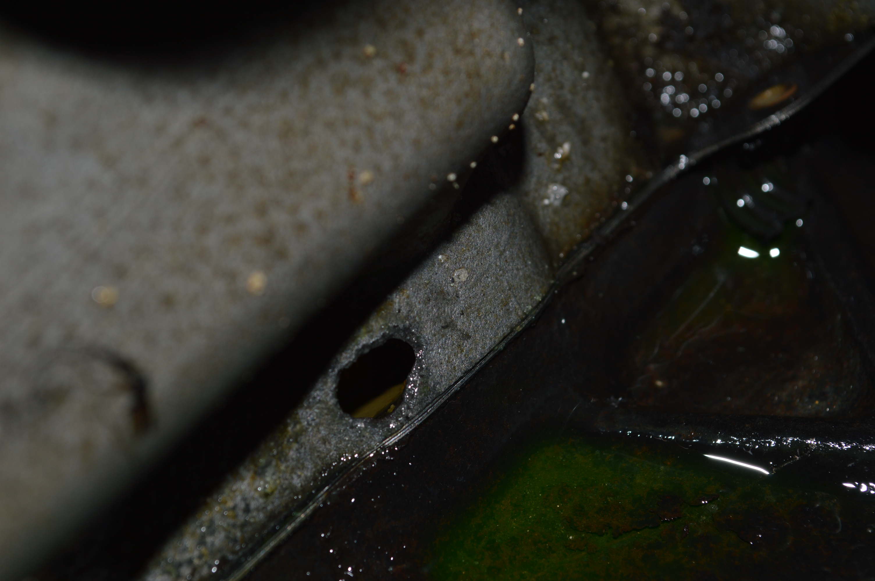

Hello ForumFolk,
We have this vehicle in from another shop. It overheated from a loss of coolant. The other shop thought it was a bad intake gasket so they pulled the intake. Once apart, they found the real cause. There is a hole about 8-10 mm in size in the RH head. It appears to be close to the sealing end and towards the rear. It's obviously a coolant port and I can see the headgasket with a restrictor port through the hole. I've checked TSB's, recalls and pattern failures to no avail. At first blush it appears to be a casting issue. Has anyone seen anything like this before?

Do you have any way of posting a picture of it? Initially I am of the opinion it may be a casting issue as I have seen a few casting problems through the years.

Re: 2003 Jeep Liberty 3.7 Hole in Head
Hole in the Head
Hole in the Head
Sorry it's a big picture. Took it with my Nikon D3200. Use the scroll bars and you'll get a REAL good view.

After seeing the picture I am all the more of the opinion that it is a casting defect.
That was my first thought, but I don't want to overlook something that may cause a repeat failure.

Update: We have the head off. Looks like corrosion was the cause. Several other ports had the beginnings of erosion. We also noted the wrong coolant installed (green, takes long life). We had done a coolant flush for poor ph 2 1/2 years ago. Now it has green coolant in it. Not from us. oops. You can also see weird calcification around the affected ports. Looks like this one was preventable.
We had done a few oil changes on this since, but this customer lives out of town so we only see her for major work. The coolant bottle is heavily discolored so it was not easy to tell the wrong coolant was in there, nor do we know for how long.
I'll load the new pics to our facebook site.
