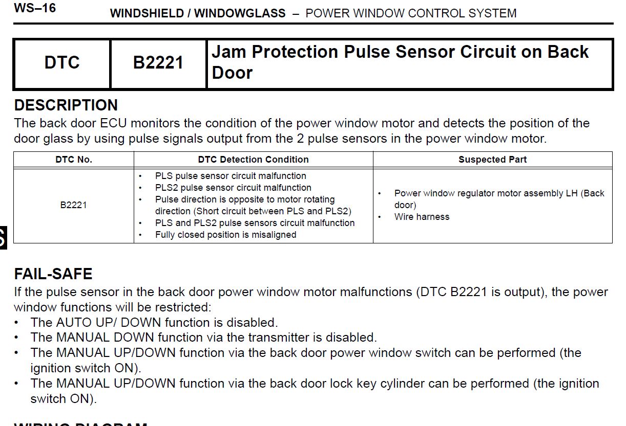

I missed the code in the post. The flow chart for that says it has 2 pulse sensors in the motor. The problem I see is it says the fail safe will work with the switch?

Re: 2005 4Runner Rear Window
That's the weird part, it doesn't. I still have not discovered why.
The pulse sensors determine the window position when initialized. That gives you auto-up and down function and wiper enable. They are similar to the drivers window motor. You usually get this code when there is no pulse activity, but the window needs to move first. That's what so confusing. Hard code with no window movement, and unable to manually move window.
Code enable criteria is not forthcoming.
