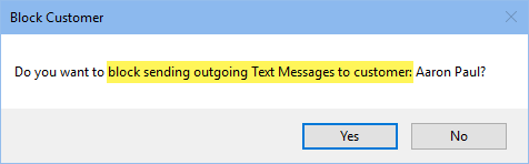

With MessageCenter texting, all customers in Manager SE are "opted in" (enabled to text with shop). Shops always have the option to opt out any customer cell # with two clicks.
Click on the SMS Allowed button under Telephone List and a dialog to confirm the blocking is displayed.

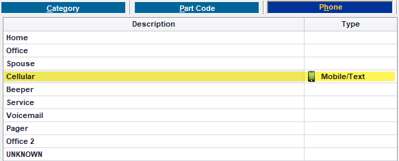

Re: Phone Number
As stated above - users confirm how they want it setup. I presume Cellular but some shops may have different labels. When you click edit you can assign the properties to the slot of your choice:
