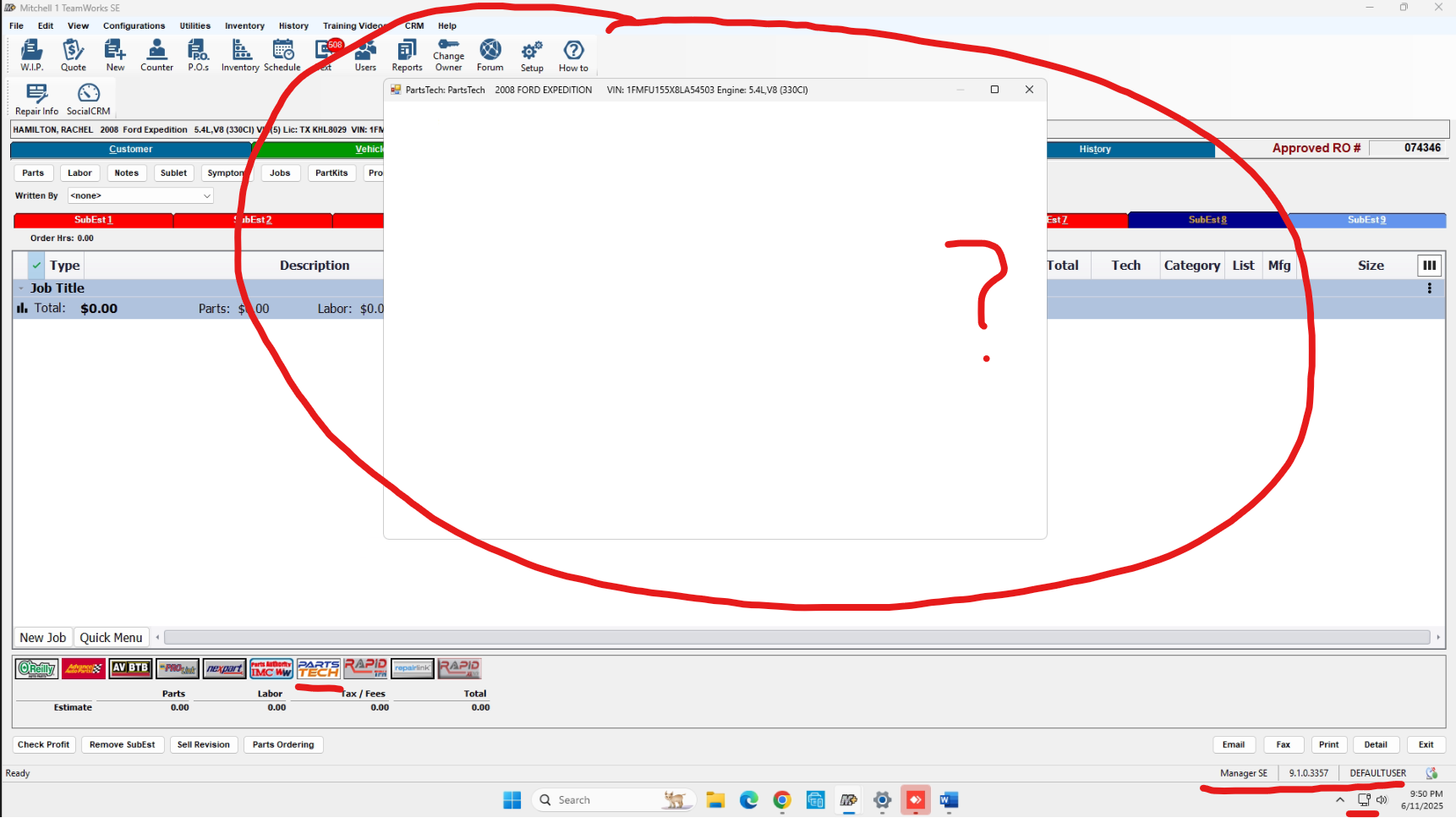

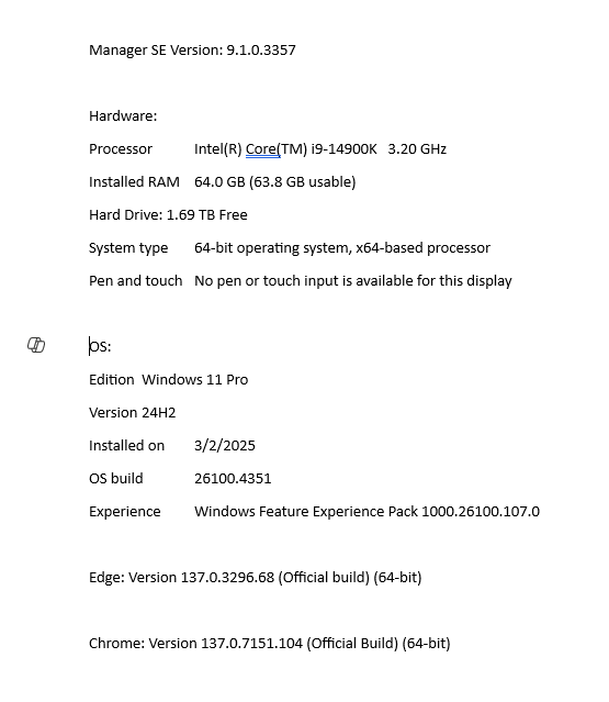

We've been having odd issues where when accessing partstech via mitchell it seems to randomly freeze/white out and we have to close it and reopen to keep using it.
We have 1 laptop, 1 AIO, and 3 desktop towers, the laptop, 1 windows 10 desktop, and 1 other windows 11, plus the 1 AIO windows 11 seem to be working fine. Except for the Windows 11 desktop tower our Service Manager uses
We have ran all available windows updates, made sure manager se is up to date, we do run off windows defender so there shouldn't be any antivirus interfering
Google Chrome is up to date, third party cookies allowed, and all permissions set to allow for the partstech website - the third party cookie thing was suggested by partstech email support
All other steps have been done: toggling the vendor plugin off and on, clearing cache and cookies, clearing the temp files, making sure partstech is in trusted sites in internet options, reboots, chrome performance settings toggled, the excess animation feature toggled but the issue seems to continue. Spec Sheet and screenshot attached.
