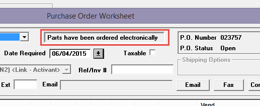

By manual PO do you mean a non-electronic vendor? If so, there is no mechanism to trigger the 'ordered' step, so no highlighting will occur.

Perhaps there could be a window similar to this that appears when the manual order button is pressed that states, 'Parts have been ordered Manually'.
This way users can enjoy the benefit of highlighting even if they have no electronic vendors. :D

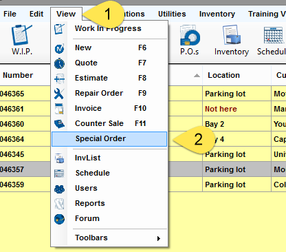

Consider using Special Orders for parts ordering in advance of an appointment. Everything tracks just like an RO and you know exactly what they are for. You can start a Special Order from scratch from the WIP screen by going to View> Special Order.
start a special order from scratch
