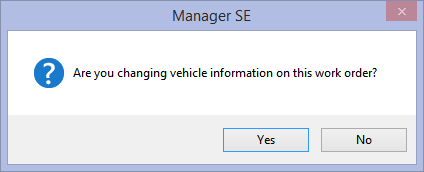

I'm not seeing this, let's break this down to understand better.
I have an RO on the screen and realize the vehicle is a 4 door SW and not a 4 door sedan; so I go to the Vehicle screen and change the body style. Click the Order tab and the system displays this:
I answer yes and continue with the order.
As far as VIN goes, we made the determination that VIN is unique like license plates and in use one instance at a time. You might recall this post where Change Ownership is used to handle any temporary VIN change situations: http://managerforum.net/viewtopic.php?f ... hip#p88394
