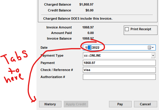

Just upgraded from v8.3.1.40 to v8.4.0.85 today. Went to apply payments on invoices and after you select/key the DATE, you used to be able to hit the TAB key and it would go to the next box, which was PAYMENT TYPE. Hitting TAB now bring you down to HISTORY.
So you have to either hit tab like 5 times to get where it was suppsoed to go, or move hands off keyboard to mouse, click, move hands back to keyboard to type again. Seems tivial, but when entering 70+ payments a day, it is already annoying on the first day. I attached a picture to try and explain what is happening. Let me know if my description is not good enough.

Hello bonabros1956,
Thank you for bringing this to our attention, and welcome to the Forum. I do see that the tabbing is a little excessive compared to v8.3.1.40. This change was to bring the selection back to the Payment Type drop down like it was in v8.2.1.81. I do notice that the tab order in v8.4.0.85 is different than v8.2.1.81. In v8.2.1.81 there were four tabs required to get to the History button.
I am more than happy to put in feedback to make the tabbing to history back to what it was in v8.2.1.81.

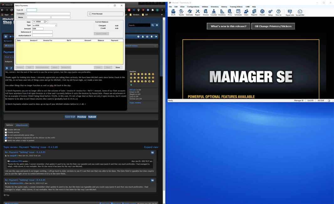

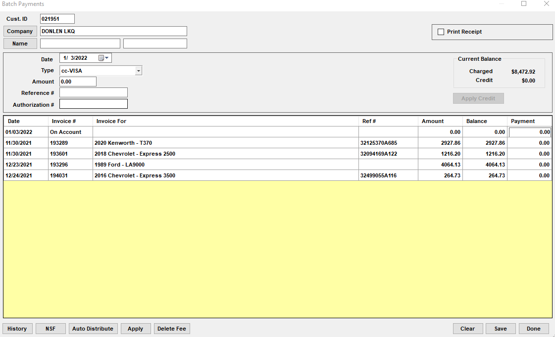

1) Batch Payments you are no longer able to sort the columns of Date / Invoice #/ Invoice For / Ref # / Amount. Some of our fleet accounts will have anywhere from 5-60 open invoices at a time and I currently believe it sorts the invoices by Posted Date. Please see attachment #1 for an example of invoice 193601 being listed before 193296. In this case, it's not a huge deal as there are only 4 open invoices, but it would be helpful to be able to sort these columns like I used to (probably back in v5.9.x.x)
2) Batch Payments window used to show up on top of your Mitchell window before 8.3.1.40. I took a screenshot of how this shows up on my window. Again, no the end of the world, just have to move the box with keyboard hotkeys I have set up.
