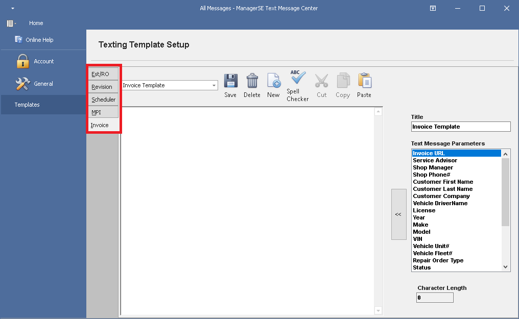

With 8.5.1.419, you are now able to text invoices which means we needed to split out the templates we had before under EST/RO/INV to EST/RO and INV for another. From what it sounds you were on an Invoice phase which means you'll need to create canned/templated Texts for Invoice.
