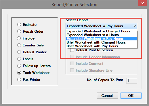

Consider using one of the worksheets that show pay hours instead of billed hours.

I tried that with both pay hours and charged hours and both still show the same labor timericmorin wrote:Consider using one of the worksheets that show pay hours instead of billed hours.

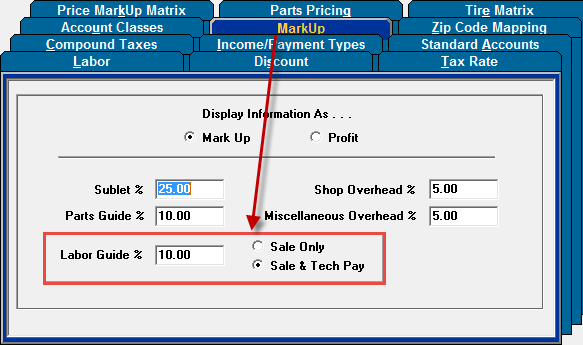

Is it possible your Markup - Labor setting is to provide the same?
- pay.png (16.87 KiB) Viewed 4511 times

Yeah, we have it as Sales only. Thing is if you do Sales and Tech Pay, then that would go towards the Tech as well?timbre4 wrote:Is it possible your Markup - Labor setting is to provide the same?
Our Mitchell1 Sales Rep came in and told us to put the labor % in at 10 instead of changing the labor rate and instead of paying to the tech for the difference.
If you have Mark up at 10% for Tech and Sales, but then when you go to Tech Worksheet wouldn't it show the same as before with Pay and Charged?

I share that advice with reps and shops that it is possible to discretely get some more for the work over time and not touch that visible shop rate that people get emotional about.
My remark was based on your saying that it was the same results with either style tech worksheet, which is apparently not the case.
I go to the Estimator and transfer a Brake operation @ 1.0 Hrs. With my 10% Markup setting (Shop Only) it appears as 1.1 hours on the Order screen.
When I use the Expanded Tech Worksheet w/Charged Hours it displays as 1.1 hours
When I use the Expanded Tech Worksheet w/Pay Hours it displays as 1.0 hours
