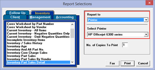

Duplicate printer entries can be created when the printer's USB cable is plugged into a different USB port.
Check that this Printer setting is set to the actual printer and not it's invalid duplicate; EOD uses this setting.
