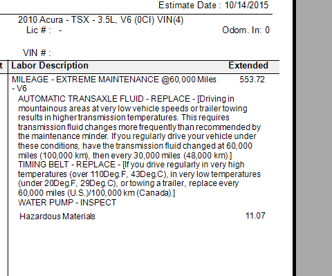

ok, so what am I doing wrong on a 2010 acura tsx? Can't get all the details to show up again.

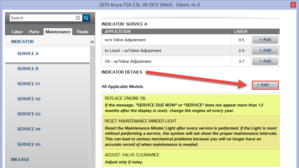

Are you clicking an application ADD button *and* the Details ADD button too? If no on the latter, then the detail lines are not transferred back to SE Order screen labor item.
- maint.png (100.07 KiB) Viewed 7955 times

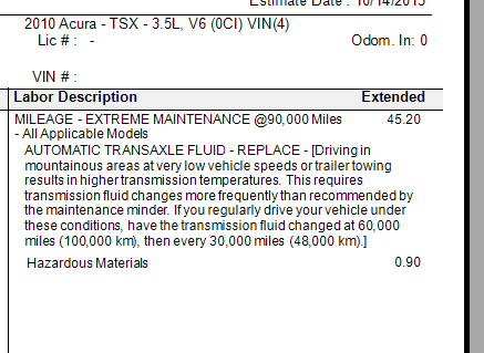

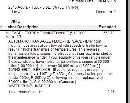

I went in through the extreme mileage option under the maintenance tab on the left hand side of the screen. Not through the Indicator, Service A, etc
It starts to show more information but it doesn't continue to display it....

Just took a look at this. Transferred the three items on Extreme mileage based work. Got the following.....
Honda's and Acura's don't have much in mileage based maintenance any more. Everything is condition based now. Is there still something missing?

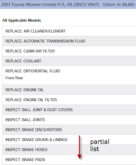

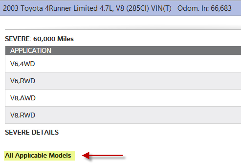

I don't know how to do a print screen so that it shows up here. But what I see, is most of the time not what you are displaying on your answers.
Case in point again. 2006 toyota highlander.
I just did a select all and copied the entire screen.
What I see is not consistent unless I look over and over.
My first time only showed
Replace timing belt.
After I went back and forth multiple times it now displays all of the info. Same thing happened on the TSX.
Now that I have done it about 6 times as I try and figure out what's going on, I get the list below. Which I still Only see when I transfer it to a revision or an RO. I never see it on the maintenance screen.
