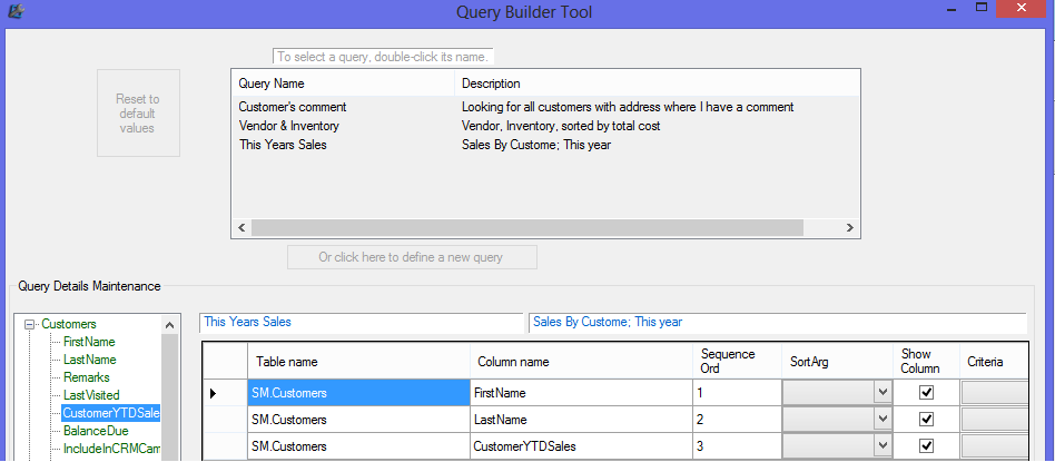

Open Report Pro - Click on Tools Tab
Then Click Query Builder:
Report Pro - Query Builder Button
Then add a new definition; simply double click the fields that you want to add:
Report Pro - Query Builder - Year To Date Definition
