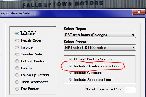

- Posts: 4537
Re: Estimate Printing
Go to Configurations, Setup Reports/Printers and confirm Estimate print settings. Specifically look at the Include Header Information box to confirm it is checked. If that box is unchecked, the shop information is not printed (or displayed in print preview).
This would be turned off for Invoices (to support space for SE shop logo graphic) but not likely for Estimates.
Make sure the check box for Include Header Information is checked.
- Fallsheader.png (172.81 KiB) Viewed 4280 times
