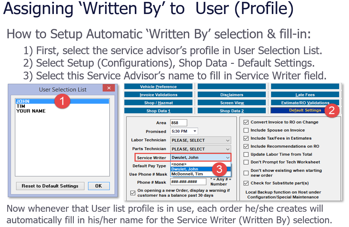

Hey all,
Apologies if this is posted in the wrong place. I'm not here often.
But congratulate us! Our little shop has grown to the point where I had to get a second service advisor seat. So is there a way to assign a default service advisor for a second physical computer? I have myself assigned as the primary through
Configurations > Shop Data > Default Settings. I see that I can change that to <none> and then flag "'Written by' has not been entered" under Invoice Validations, but I'm hoping to automate it. We will not often use each other's computers, if ever.

First make sure you have the user set up, then set the default advisor while on that user. After that, every time a new Estimate, RO, PO, etc is created, the name will default to that person.
Re: New service advisor seat, set service advisor default?
Congratulations!
Yes. Each service writer needs their own USER profile. When selected (USER name appears in lower RH corner of screen), go to Configuration > Shop Data > Default Settings as shown below:
assign written by.png (247.95 KiB) Viewed 10045 times

Thanks Timbre. That worked!
