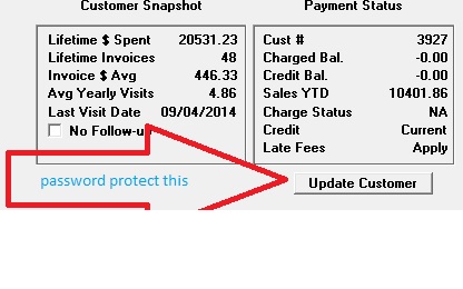

Hello, I may be able to shed some light on your question.
part 1. For some reason any payment made that resulted in a credit with an invoice number, or any refund issued with an invoice number shows up as a credit amount on the Accounts Receivable Aging Summary forever when it was applied to an invoice. If it has been applied to an invoice it will not show up in balance due column, NOR on the balance due statements.
if you have a listing with the same amounts in the on account and balance statement with 0.00 in the aging columns. Some one has been applying credit on account through the update customer box on the customer screen.

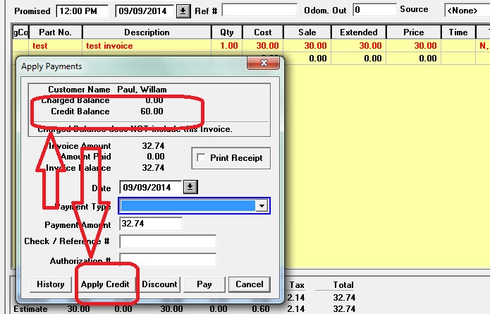

Part 2. When a customer has a credit on account, to apply the credit to an invoice follow these steps. Have the invoice in the payment screen.

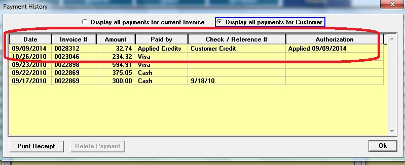

this is what the payment history screen will look like

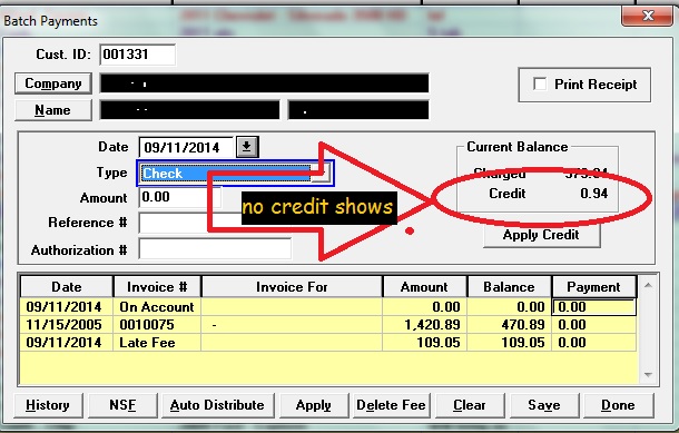

There is an issue. I just got off the phone with Kay. When she is in batch payment. She posts a payment larger than the invoice amount. The remainder goes in the "on acct" box. The problem is.....The credit does not go to the customer. It just disappears. The credit amount does not show up in the customer snap shot as a credit. Leaving her no way of knowing the customer has a credit on account.
Works as should on my 5.9 her system shows 0.00 credit
