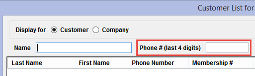

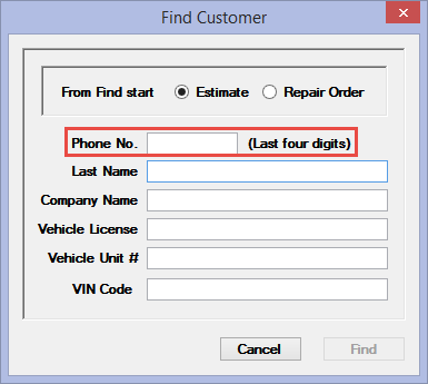

The NEW / F6 window to lookup customers and the F3 Find Customer function both indicate that the last 4 digits are used to search on: On the Work-In-Progress screen, a right click on a Telephone field reveals a Search box where *any* portion of the phone number may be entered: I will see that we add a Knowledgebase article for this.

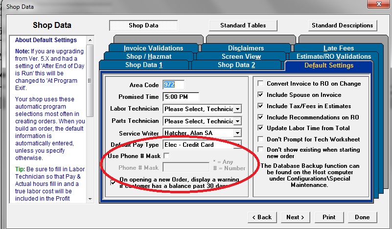

Re: Search By Phone Numbers?
So what exactly am I to do with this setting to enable last four digit phone searches to work correctly?
- phone_number_settings.jpg (167.31 KiB) Viewed 4397 times
Not sure if it will fix your issue, my "use phone # mask" is checked to be used. Maybe check the box and try the search again. I have never had an issue with searching for a phone number, and that box has always been marked.
This is not usually an issue.
Use Phone # Mask should NEVER be unchecked. Please get that box checked and confirm that the mask is ###-###-####. Then try it again.
YEEHAW!
Checked the box and pasted ###-###-#### where it's supposed to be and phone number search works! While I was in there I took out the default area code since the DFW metro has so many different ones now. Checked a few customers in the WIP and it appears Manager has fixed their numbers to fit the "new" format.
