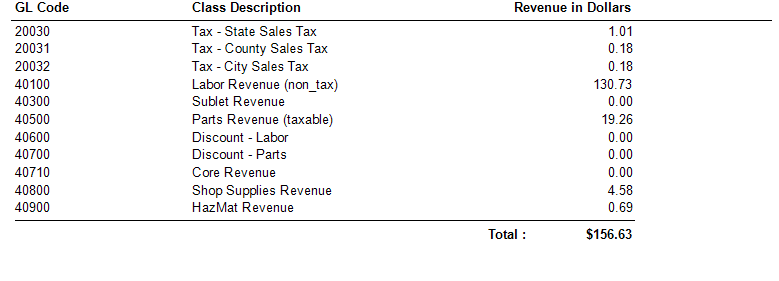

If you setup your three taxes as different rates with different GL codes, they are very easily tracked.
For example. Here are the taxes broken down the same way you're proposing.
Then I created a dummy invoice, to show how this changes the way invoices will display a new tax breakdown:
And finally, running the Revenue by GL Code Report at the end, each remittance is quite clear:
Now, I'm not an accountant, so discuss with your bookkeeper before doing this.

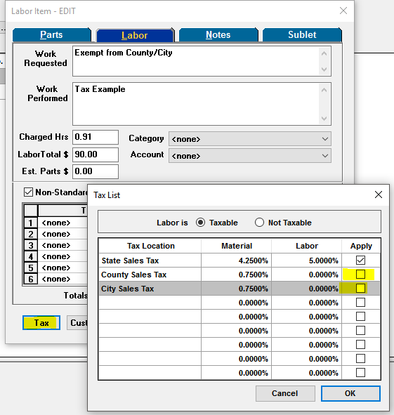

I'm not sure if follow you completely, so I apologize if this isn't relevant, but any given item can be taxed differently from the whole of the order. Sticking again with Paradigm's original topic idea, if we break down State/County/City, then only need to collect State on a given item:

There may be a way to work around this, which is probably what you're doing now. Sticking with your example, the first line here is marked as non-taxable, and the second is taxed normally. If I'm misunderstanding this scenario still, could you provide a link to the Washington state tax legislation that explains this?
