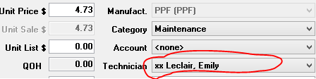

Yes. Here is a part from an order from 2003. The tech no longer works for me and has been deleted. Notice the x's in front of the name.
Example of deleted tech on a history part record.
