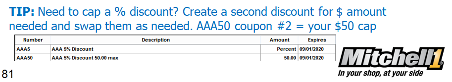

Is there a way to put a cap on a discount? example would be 10% on parts and labor with a $50.00 cap. Much like we do with shop supplies.
Re: Help With Discount Coupons
While the Discount Coupon by percentage method doesn't have a Max parameter, you can create the same effect by having a second discount by DOLLARS method that is equal to the cap amount. Here is an example we show in the workshop events:
