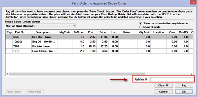

2. Why is the ref/inv# not feeding into the item like it is being attached to at the time of the receipt?
I do not understand why I would have to re-enter this number especially if I am liking the receipt to the order line.
This means I cannot back-track to my purchase for warranty items.

The Ref/Inv # text is entered in the Parts Ordering window when parts are ORDERED not when received. When the electronic parts order (PO automatically created at same time) is transmitted, the Ref/Inv # is copied into every part item being ordered at that time (on that PO).

#2 not sure how i am supposed to know the vendor's invoice number at the time i place the order...
what about manually ordered parts???
since this field feeds to the PO receipt, and then becomes vendor invoice number in QuickBooks, it really needs to be the vendor invoice number once it is available.

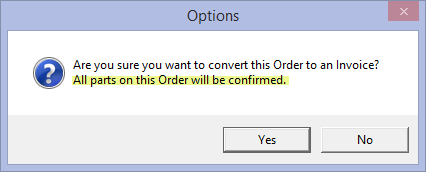

#3 when receiving a PO, the system is absolutely 'confirming' the items, and adjusting inventory
the popup you showed me is a duplication as the items are in fact already in 'confirmed' status

#2 - No you cannot know the Vendor invoice # until you receive the parts order. You mentioned the Ref/Inv # field (entered at time of order not receipt) and so the discussion went in that direction, I would agree that is how it should work; we have an enhancement request for the PO receive process to allow entry of vendor's invoice # and apply it to all of the parts received on that PO.
#3 - For sake of clarity, let's keep Confirmed as an Invoice parts state and use RECEIVED (part lines turned green) for PO parts. IE They are seen by the system and QOH is increased where inventory records exist. If the parts are to be used on Repair Orders in the Shop they are COMMITTED as the Part Item Edit window for each of these items indicates (and Inventory record IF they are stocked items). They are not CONFIRMED until the RO is converted to Invoice, subtracted from inventory (if applicable) and Committed falls back to zero.

Keep in mind that there are TWO checkbox options for receiving PO parts. 1) Receive to ROs wherever possible (as you mention doing), 2) create an Inventory record if one doesn't exist. Do you use this or no? If these are one-time pass through parts you don't expect to stock, I believe you are not. When you receive a non-stock part and dispatch it out to the RO, it's a wash. (needed one, ordered one, received one, done) If you made an inventory record it would have QOH zero.
As for the Confirm checkbox, historically that would be checked when the RO was converted to INV. Users could also use the Confirmed checkbox to take it out of inventory EARLY so as not to be oversold. This morning I have run through a PO part ordering process on 6.5.34 and I observe something new; as you say a) green line, b) '+' appears for line and c) Confirmed checkbox is checked. I have made an inquiry to know precisely in which circumstances this occurs.

I forgot to mention that the value typed into the Ref/Inv # field is put into the item's field at the time the part is ORDERED. (actually possible during Parts Ordering window Price Check function) So the not receiving part to the RO has no bearing on it's inclusion with the part at the item level.
