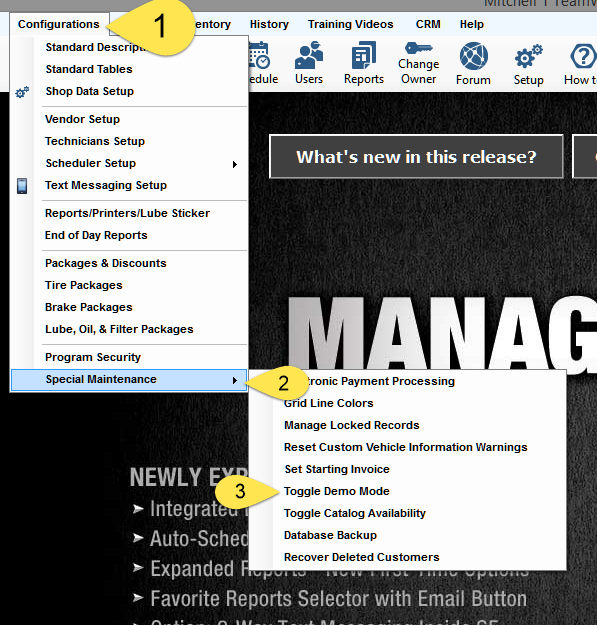

Way back in the day, wasn't there a "practice" data base? Where we could get in and mess around, learn the system. Then flip to the "real" data base and do it for real?
Re: How To Delete An R.O.?
Rich wrote:Way back in the day, wasn't there a "practice" data base? Where we could get in and mess around, learn the system. Then flip to the "real" data base and do it for real?
Yes. From the splash screen, do this.......
That may be the best place for them to "play around" then nothing gets messed up, that has to be un-messed up when they want to do the real thing

Our training concept is for new users to toggle into the DEMO version (Configuration menu above) and work through the LEARN workbook file to run through the basics without typing that stuff into your LIVE Manager SE. Details and docs at this link: http://www.managerhelp.buymitchell1.net/docs.htm
