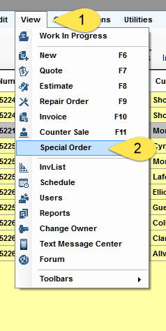

You may very well use special orders for neat and interesting ways. Here's how they are designed to be used.....
Let's say you have an existing order with several labor operations on it. It is discovered that one or more of those operations cannot be completed because the parts are back-ordered. You finish the rest of the work. You will highlight the labor and parts to be deferred and then go to View>Special Order. You'll get a window confirming your actions and as if by magic those parts and labor are moved from your Repair Order to a newly created Special Order. You can differentiate these from Repair Orders as work that is not here but parts have been ordered.
In fact, we create a Special Order from scratch EVERY time we need to order parts in advance of the cars arrival. To start one from scratch, from the WIP screen click on View> Special Order. You'll get a blank SO where you'll need to add the customer and vehicle manually. Add the labor and parts and you'll have full PO functionality (unlike ordering parts from Estimates).

Thank you for your speedy reply. All of the scenarios that you presented will work perfectly for the ideas I have with regards to open labor claims against parts warranties. But at the risk of sounding completely stupid, or at the very least blind, I can not find the "view" button you are referring to to create a special order. I have an open repair order, I have highlighted the labor and parts lines I want to carry over to a special order, .....but then I'm stuck....

Re: Special Order
No worries. It's hidden in plain sight. :D

Scratch that last thread....dummy me was looking for a button!!!
I have transferred all my open labor claims and de-cluttered my WIP screen....very cool!!!
