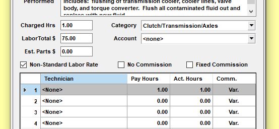

Here in our shop we use different labor price levels. For example: Vehicles including cars, vans, and pk trucks up to and including 1/2 ton are one labor rate. Trucks and vehicles 3/4 ton and up are a different labor rate. Can I build canned jobs using different labor rates? When ever I want to build a canned job for trucks 3/4 ton and up, the system wants to use the lower labor rate. My objective for doing it this way would be so that i can bring up a report based on the different labor rates.

Probally going to have to set up multiple can jobs and
and check the box for non standard labor rate in each and make them as you wish.
