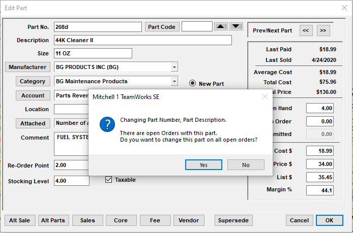

Thanks, I just tried this again and this is what I got, so having to go into the system to update is going to be a bear.
Screen shot.png (112.16 KiB) Viewed 19381 times

cbalogh wrote:
Tue Jun 20, 2023 11:12 am
That is the same message I get even today yet when I try to change an inventory part that is in use on an existing order. Maybe there is a setting I need to change.
