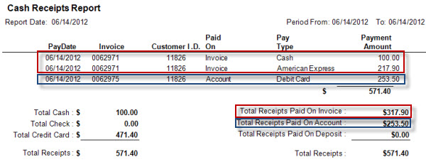

It sounds like you're not posting invoices on the same day that payments are being received. If the system sees payments for an RO, this is Paid on Deposit. If a payment is rec'd on an Invoice but the Invoice is NOT posted that same day, it also interprets this as a deposit since it's not posted.
Here are a couple examples where all is done in a linear sequence in the same day:
RED = Invoice with a split payment; both seen as Paid on Invoice
BLUE = Invoice posted as Charge; payment seen as Paid on Account
If you keep these things in mind, the program behaves as expected.

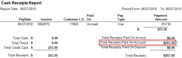

Okay, I went back to that second invoice (June 14th) above and deleted the payment. This makes the invoice due and payable once again. So here is the sequence and the outcome.
1. Work completed and invoice posted on 6/14
2. F5 Batch Payment to process payment on 6/27
3. Run Cash Receipts - it shows as payment on account (correct) and deposit remains zero (not applicable)
Since I'm showing actual samples of how the system works properly and I cannot replicate what you are seeing, I suggest that you contact tech support ASAP, as investigating this further is beyond the scope of the forum.
