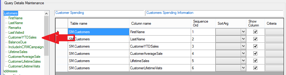

Simple query builder for Manager SE; check out the image below from Report Pro
Report Pro Query Builder
