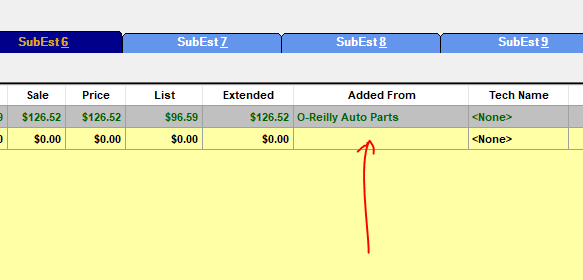

The programmers have added the 'Added From' column on order screen to help with this. This DOES get populated when pulling in parts from electronic catalogs. That makes it real easy to order the parts later. As you've stated, the field in question gets populated upon ordering.
If I had to guess, I'd say it was problematic to populate that field during a part import/transfer, so much so that they added a completely new field to comply with our requests.
