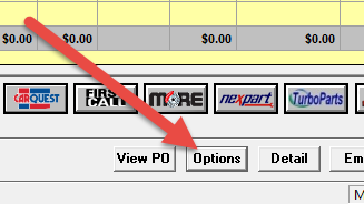

You can link manually created PO's now. Once parts are on an approved repair order, click on Options>Pick List to make the PO. It will be linked to the RO.
Re: Linking Manual Purchase Orders to Repair Orders
Welcome to the forum and thanks for your posts.
You CAN link manual POs to your Repair Orders, it's been available in the software since 1998.
By using the Order Options -> Pick List -> PO workflow the resulting Purchase Order is linked to the RO you started from. Pick List will display outstanding parts needs (subtracting parts on hand) and then the Pick List is converted to PO and transmitted to the vendor by phone, fax, email, IM, whatever. When you click on View POs for the order it will be listed there just as if you had ordered from an electronically connected vendor.
NOTE: Your system should be set to Mark All ROS as Approved / Printed (Setup - Shop Data - Screen View tab checkbox) or you are manually marking the RO as printed to make the parts need visible to Pick List process.

ricmorin wrote:You can link manually created PO's now. Once parts are on an approved repair order, click on Options>Pick List to make the PO. It will be linked to the RO.
Will this mark the parts blue/green as well?
On second thought, I believe it's the ordering part that triggers the highlighting. Since there is no order command on a manual PO, there may not be highlighting. On a manual PO, it's creation is proof of ordering. (an internal discipline)

Manual POs do not flag the highlights. I think this would be a helpful feature since the part is being "ordered" even if in a round-a-bout way. Maybe an on/off option within Setup?
The more I think about it, the more I agree. I was just looking at an RO left over from Weds and we were waiting on parts, lots of parts. Some came from our electronic vendors but the majority came from the dealer. The electronic vendors had a visible indication of ordering but the dealer parts did not. I got nervous and opened the PO button. They were ordered.
Perhaps an 'order confirmed' button within the PO? Click on it when you order the parts. The button could enable the same code that the 'order' button does with electronic vendors. I'd make that an enhancement request. :D
The flag in the Inventory table is triggered by electronic ordering activity (used most of the time). It would be necessary to first measure feasibility. I agree it would be nice, I'll inquire as to the potential.
