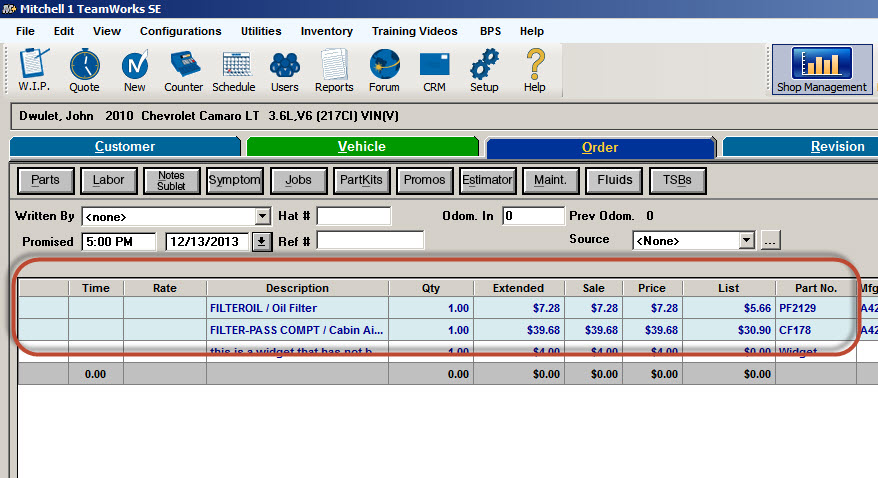

Personally I like the way it works. I can post parts from different vendors on my order, check the pricing, delete and order.

I'm thinking you just recently upgraded to version 6.4 from version 5.9 and the catalog in question is either Nexpart or ACDelco Wise. If this is the case, you can install a different version of those catalogs from http://m1faqs.com/fix/SE/catalogs/whi-acd.exe . While this version of the catalog allows you to order from within the catalog itself, it does not create a purchase order and parts added to an order in ManagerPlus will not be highlighted when ordered in this fashion. (Note: Highlighting? Version 6.5 of ManagerPlus - due soon - will highlight part lines on orders when the system 'sees' the part as ordered.
