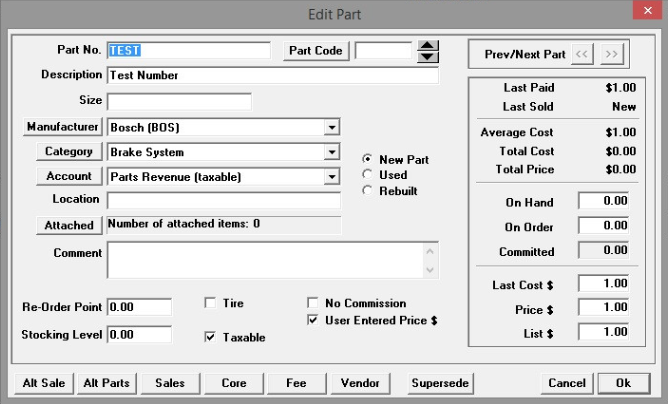

I created a test part number:

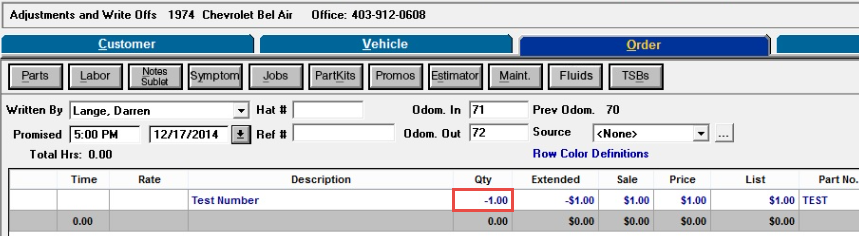

I then created an invoice wherein I am returning it:

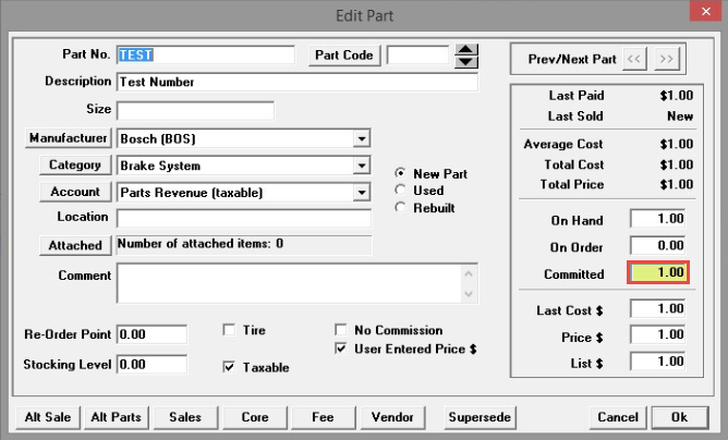

Upon confirming the part, it shows one in stock (as it should) but also adds one as committed. Deleting the part from the invoice does not change it's status as committed, nor does it turn up on any "Committed Parts" reports.
