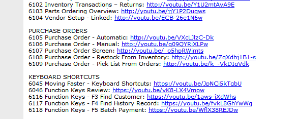

Re: Can you use PO function without having Inventory
http://www.managerhelp.buymitchell1.net/Howdoi.htm
Scroll down to the PO videos!
(i think you will want line 6106)
Okay thank you those are great! Now I just need to know where to find those buttons my screen doesn't show any of that. I can order and all as such, but I have no PO buttons or anything like that? Our version is 6.4.608.....

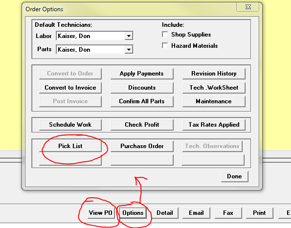

hmmm. 6.4...We have inventory here, so I am not 100% sure our systems will look the same. If your in an RO do you see a "View PO" button on the bottom, toward the right side? And next to it is an "options" button, click on that and a window pops up, see if there is a "pick list" button. I am thinking Tim or JD will go helping you out now. Sorry, we have always had the PO option, so I wont be much help.
- Capture.PNG (28.96 KiB) Viewed 6926 times
When I go to that screen there are two buttons there but no lettering not even grayed out? Just non clickable buttons

- Posts: 4537
Once upon a time (prior to 2014) we maintained two levels of product Manager (parts list only) and Manager Plus (inventory/POs). Beginning with SE 6.5 we consolidated to a single "plus" version that gave you everything.
Purchase Orders are created automatically when ordering parts from an electronically connected vendor; you may also use the Pick List process to generate a manual P.O. as needed. The videos referenced above explain all this.
If you have parts on the order and the 2 buttons are dimmed, this is because you're looking at an Estimate or a Repair Order that has not been marked as Printed / Approved. You can set this to happen automatically on the Setup - Shop Data - Screen View tab.
Please contact customer service and request you be upgraded to 6.6.14. Because the automatic updates didn't start until SE 6.5, they will need to send you a disc update to get you there. Then the AutoUpdater will send a notice that a newer version than the disc install is available.
