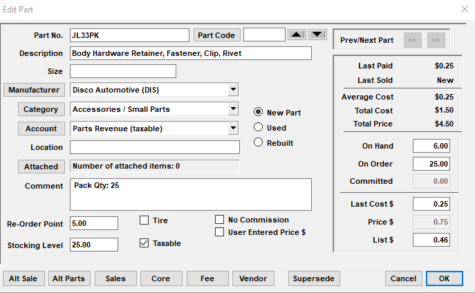

So question. I've recently started working in the POS for stock items that we keep track of so I can automatically update the quantity on hand all at once instead of going into each individual one.
So my question is, is there a way to make "x" being ordered, but have it split down to "xx amount" when being converted into inventory?
As Example:

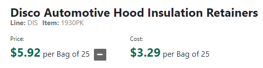

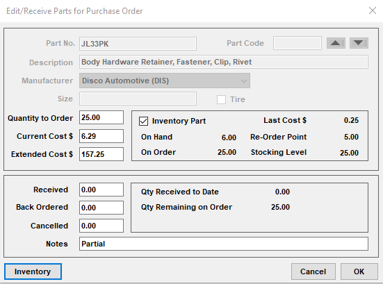

In order to track these rivets correctly we have them singled out to price them better on each individual invoice. But when you transfer it over to the POS, it will pull up the amount needed ( I adjusted this so we get a full back of 25). Right now I have to hand order the items myself but I still do the price check. Eventually it would be nice to order directly from the system, but thats not an option at the moment. But say it was, it would put an order out for 25 packs of 25 Rivets, which is alot of money, and we don't go through that in a year. So I wasn't sure if there was a way to convert it down. Like say have it set that it orders 1 pack of 25 but when it gets entered into the system it converts the 1 pack down to 25 when adding it to the inventory. It would be nice to have the reverse too, but right now I'm just worried about it going into inventory since I'm hand ordering myself. I attached some examples if that helps.

I do this all the time. For those items that I order electronically AND come in package quantities BUT I sell them individually, I do the following....
Set the price for the individual sale by dividing the quantity by the package price.
Set the reorder and minimum so the package quantity appears correct.
Place a note somewhere so I know this is a package purchase and the quantity.
Now when I reorder, I manually change the quantity to one and place my order. Then I go back and reset to the correct quantity and individual price. When I receive, all is as it should be.
For items that come in a 2 pack or other small quantities, I order and stock as is, noting in the part description of the individual sale, ie: .5=1 or .25=1. Ordering these requires no manipulation.
