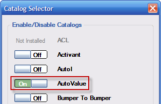

You could keep the old vendor setup until you're sure and just create a new linked vendor record. If need be, go to Configuration - Toggle Catalog Availabilty to make sure the AutoValue option is turned on for button display and proper setup link type.

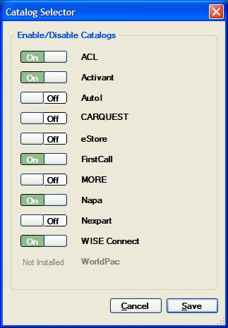

Re: Auto Value e-catalog
From splash screen, go to Configurations - Special Maintenance - Toggle Catalog Availabilty and look for this:
You're either not at 6.4.521 or the DLL files are missing/corrupted.
Go here and get option #4: http://m1faqs.com/fix/SE/catalogs/
Close SE, run that and then re-start it. You should see this option.

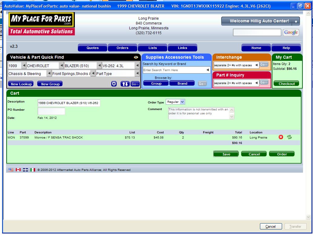

I am having the same problem as Eric, transfer button is greyed out.
I have added the parts & viewing the cart.
I just repeated my steps here and it works.
The visual cue in your screen capture is you should NOT be seeing the Save / Cancel / Order buttons at all. I have to ask one time, this catalog view was triggered by clicking the AutoValue button in SE and not as stand alone in the web browser? That would be the only reason I can think of that those buttons are visible to you.
It may be necessary to contact support to see why this is happening.

Yes - I did click the newly installed AutoValue button to get to this screen. I will call tech support & see if they can figure it out. We are getting to be pretty good buds :wink:
