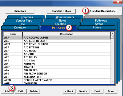

is there a certain screan on need to be in to add a new part code ? it keeps telling me i need a code to save it , any ideas anyone

Yes. Text entries like that are handled in Setup screens. Go to Setup - Standard Descriptions, Part Code tab as shown below:

- code.png (48.55 KiB) Viewed 4068 times
