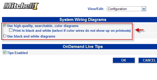

Re: Poor Wiring Diagram Printing Quality?
These look like the "backup" diagrams if SVG color cannot be rendered or if certain user configuration settings are selected.
Please open your od5.com as stand-alone program in your IE browser so that you may go to Setup - Configurations and check settings: If the Print black & white diagrams box is checked, uncheck it and try it again.
Tim, they are not enabled. The diagrams are in color. I printed one, then scanned it in so you could see the quality.
Here is the current setting and what it's set to.
Let me know if there is anything else I can try. The owner is furious!
Thank you for your input.

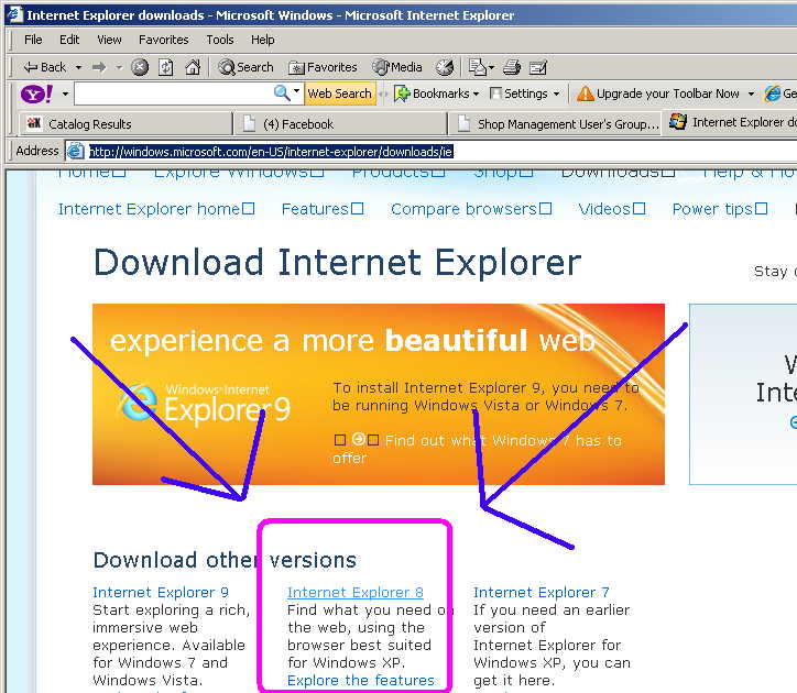

- fortknoxx
- 1500 Club Master Plus Contributor
- Posts: 1873
- Joined: Wed Sep 13, 2006 6:09 am
- Location: High Point, NC
- Contact:
- Attachments
- ie8.jpg (75.13 KiB) Viewed 24771 times
T-N-T (Tina Nuse-Tolar)
Gone but not forgotten...Camper Bob's
609-760-7079 Cell
609-760-7079 Cell
Thanks for that link Tina,
Windows 7 is not listed so should I download the XP 64 bit version?
If you know you have a 64 bit PC, yes.
If unsure, confirm with this info: http://windows.microsoft.com/en-US/wind ... -or-64-bit
