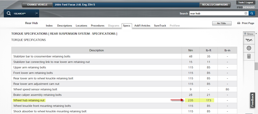

UPDATE: We DO have this listed as wheel hub retaining nut; enter 'rear hub' in 1Search, then Rear Suspension specs table:
sbcauto
Posts: 145
Re: Torque Listing
Post by sbcauto »
Thank Tim
Will Look Again.
