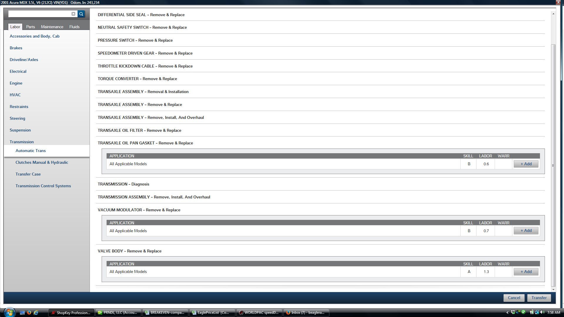

We were recently estimating a job on a 2001 Acura MDX. Looking through the transmission labor options there are a number of items we noticed that may be....questionable?
First, the valve body replacement shows labor at 1.3. You'd have to be a super tech in order to accomplish that with this transmission. Then we noticed that there are labor options for a transmission pan replacement (there is no pan), then a vacuum modulator and throttle kickdown cable??
Did Mitchell1 grab a set of labor operations for an old Chevy pickup instead of an '01 Acura MDX?

Thanks for the feedback, here are some findings from labor editorial:
"In 2001-2006 the valve body is not serviced without transmission teardown (O/H) so the time was removed along with the oil pan time as there is no oil pan.
The Throttle Kick down cable is not used on this vehicle so time was removed.
The Vacuum Modulator is not used on this vehicle so time was removed."
Some of these items were part of a reusable template and this is now corrected. There is one question from editorial:
"My question is did this customer just R&R the Valve Body if so how much time did it take after the Transaxle was removed? I am just not sure Valve Body should only be replaced as part of an Overhaul."
